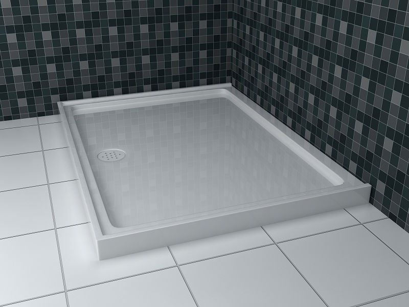

yer no different than having a shower base like this picture , as you said builder can pour flat slab. tiler doesn't need to screed a fall to run water into drain other than just the shower area, and he gets his fall by raising just that section. a cheaper way of doing it. but slightly more fashionable than having the old school white shower base.
as for the taps your in the poo with that one. if you want flip fixers plumbing needs to be re done, tiles removed job.
