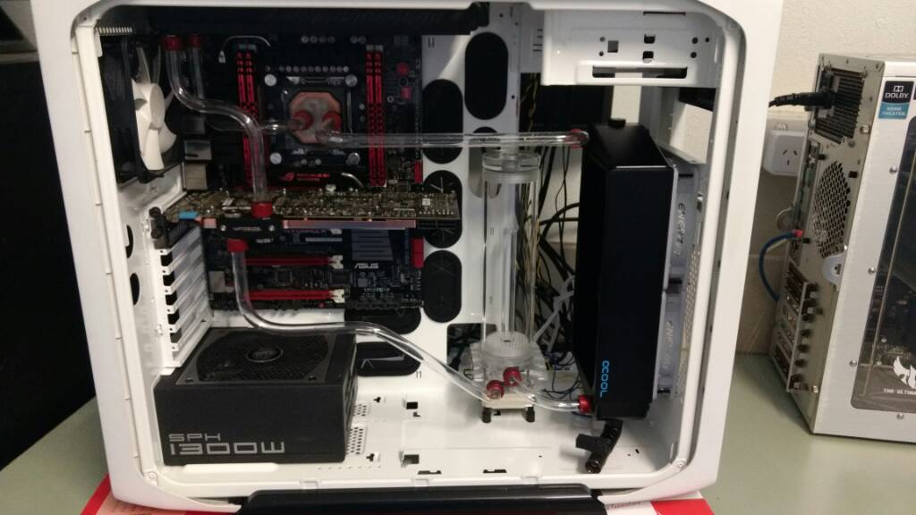

MBAF Legacy Donating Member 2,156 Member For: 9y 11m Posted 02/11/16 10:57 PM Posted 02/11/16 10:57 PM Did you do the pipework in the fluid res? Normally the have more of a space between those feed pipes and also benefit the top one pointing towards the side so it runs down the glass rather than dropping straight in... Getting excited to see this thing...so close 1
bloodycrashboy Feeling the Love :-) Legacy Donating Member 4,421 Member For: 13y 3m 13d Gender: Male Location: Not in Cairns anymore Posted 03/11/16 07:23 AM Posted 03/11/16 07:23 AM The reservoir came as you see it. the tubes are blanked off at the end and have holes around the sides of the end. they call it the "light tower effect" go to 3:30 minutes on this video and you will see. Personally I like it because you can see water flowing without the need of a flow indicator
MBAF Legacy Donating Member 2,156 Member For: 9y 11m Posted 03/11/16 07:42 AM Posted 03/11/16 07:42 AM Ahh yeah that makes sense. I was thinking the water was free flowing from the top which is why I was asking. Tower effect is awesome also stops bubbles forming in the ressy as the water flows down the sides of the cylinder. Did you grab the from pccasegear?

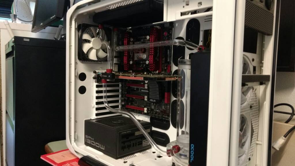

bloodycrashboy Feeling the Love :-) Legacy Donating Member 4,421 Member For: 13y 3m 13d Gender: Male Location: Not in Cairns anymore Posted 05/11/16 05:17 AM Posted 05/11/16 05:17 AM so.......... I watched a you tube video about bending acrylic tubing, and he said buy twice as much as you need if you are a first timer. Guess how much dumbo here ordered, you guessed it, not enough! Basically the you tube guy was exactly right, I got half of the job done before I ran out of tube. So looks like I wont be finishing off the build for at least another week. Anyway, here is a couple of picks of my first venture into the frustrating world of acrylic tube bending. The mistakes were many I think I will have to replace the ones that do fit cos OCD 1

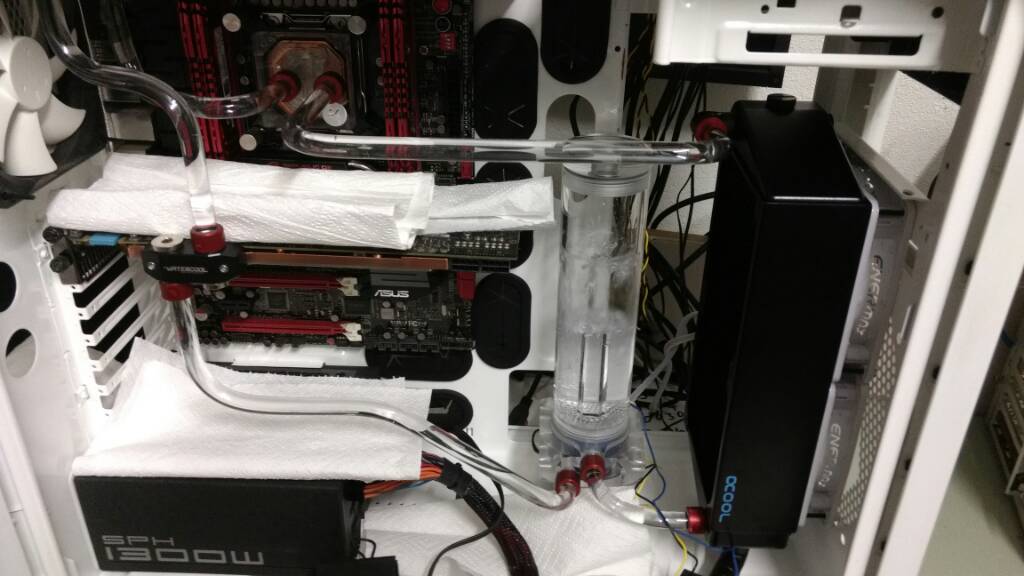

bloodycrashboy Feeling the Love :-) Legacy Donating Member 4,421 Member For: 13y 3m 13d Gender: Male Location: Not in Cairns anymore Posted 08/11/16 08:11 AM Posted 08/11/16 08:11 AM Had a win finally.Ordered some more acrylic tube on Monday, arrived at work lunch time today [emoji39]And managed to only stuff one bend this time.So here it isAlso bought some red cablingSo I'm off down to Coles to buy some distilled water so I can run a leak test.Getting very excited [emoji3] 2
bloodycrashboy Feeling the Love :-) Legacy Donating Member 4,421 Member For: 13y 3m 13d Gender: Male Location: Not in Cairns anymore Posted 08/11/16 09:24 AM Posted 08/11/16 09:24 AM No leaks (so far) yay. [emoji41] 1
bloodycrashboy Feeling the Love :-) Legacy Donating Member 4,421 Member For: 13y 3m 13d Gender: Male Location: Not in Cairns anymore Posted 08/11/16 10:25 AM Posted 08/11/16 10:25 AM the recommended time for a leak test is a couple of hours. So just mucking around with the red led's and checking out my new red cables. I'll buy some red engine coolant and add this tomorrow for color. Then finally I'll have my PC back and into some gaming 2
