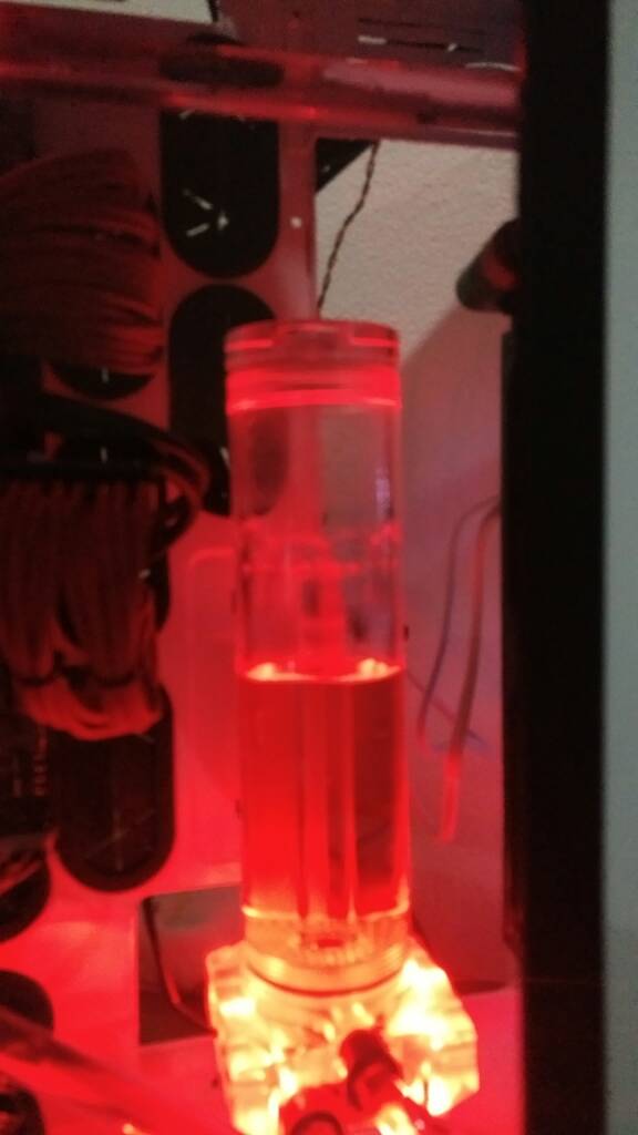

MBAF Legacy Donating Member 2,156 Member For: 10y 21d Posted 10/11/16 11:25 AM Posted 10/11/16 11:25 AM Looks awesome man. If there is a bubble give it a slight tape on the pipes before and after the block and on the block with a pen or something like that. Just light taps to doslodge it while its running. 1
bloodycrashboy Feeling the Love :-) Legacy Donating Member 4,421 Member For: 13y 5m 4d Gender: Male Location: Not in Cairns anymore Posted 11/11/16 09:46 AM Posted 11/11/16 09:46 AM Been running FurMark for just over 30 minutes.Seems to have stabilised at 55° and 65° for the GPU's.Had to shake the case quite violently to dislodge air bubbles.FIFY@Rab [emoji3] 3
Rab WOT? Legacy Donating Member 10,981 Member For: 13y 6m 10d Gender: Male Location: Frankston, 3199 Posted 11/11/16 12:31 PM Posted 11/11/16 12:31 PM Plus you drank all the Kool-Aid Needs more red and less bubbles? 1
bloodycrashboy Feeling the Love :-) Legacy Donating Member 4,421 Member For: 13y 5m 4d Gender: Male Location: Not in Cairns anymore Posted 11/11/16 12:40 PM Posted 11/11/16 12:40 PM Here's less bubbles [emoji3]Also less temperature.Was playing Asetto Corsa, noticed temps were getting lower.Ran FurMark again for 30 minutes and stabilised at 57° and 49°That's almost a 20° drop from air cooled.Sitting watching temps at idle, 29°Ambient temp, 26°Pretty happy so far. 3
