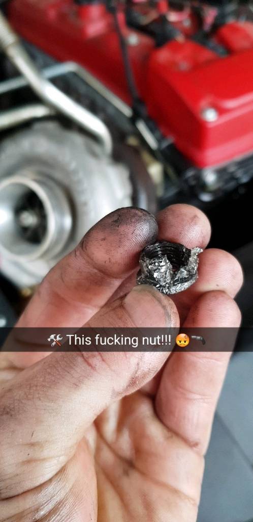

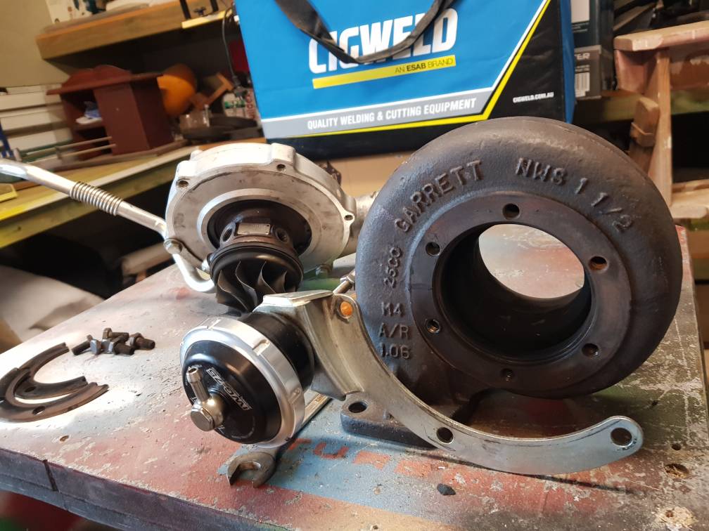

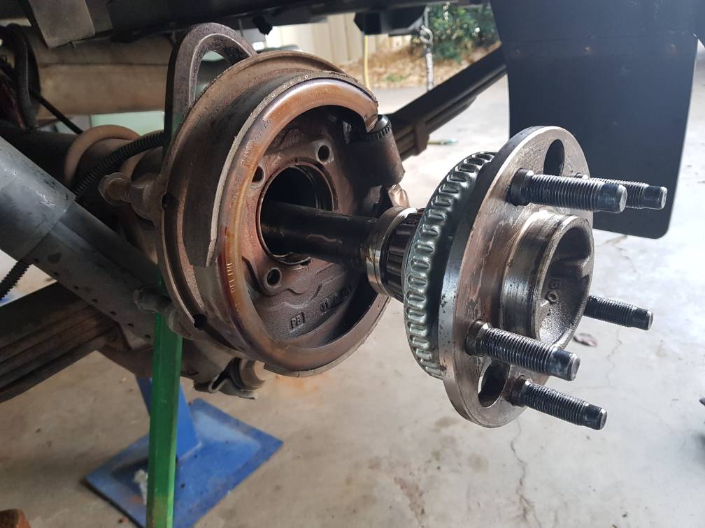

bupalooga Legacy Donating Member 262 Member For: 13y 9m 22d Gender: Male Location: Griffith NSW Posted 21/05/17 07:06 AM Posted 21/05/17 07:06 AM Very busy weekend!!!Got my turbo removed due to shot bearings with the help of a Chisel & hammer thanks to this *beep* of a seized bolt on the top rear stud.Got replacement manifold studs & nuts from local bolt shop for $0.95... I'm a little bit scared lol. Split the rear ported housing and waste gate off to be attached to the second hand turbo from Athol park wreckers when it turns up this week. Didn't have time or money to go get retuned for billet wheel CHRA or better turbo. & Garret cores had a 1month back order from all suppliers that I called so second hand unit it was. Finally completely finished the air system with train horn and bagged trailer, all controlled in the cabin. Then started to pull apart rear passenger wheel assembly as those bearings are sh*te as well. I've got it to this stage but I'm stumped as to what to do now. Ordered wheel bearing & hub assembly which also turns up this week. Any help guys? Or should I just take the whole axle into the mechanic to do the rest? Also played with new foam gun & SuperSyrup car wash. Good Aussie product! 2
bamk2f6tornado Legacy Donating Member 777 Member For: 12y 7m 25d Gender: Male Location: Rockhampton Qld Posted 21/05/17 07:38 AM Posted 21/05/17 07:38 AM To remove the bearing you just put a cut in the bearing retainer with a die grinder then smack it with a chisel to break it. Same goes with the bearing. The bearing carrier will chisel off then you will have to do the same cut with a die grinder to remove the last of the bearing case. Then just press the new stuff on. Don't use sh*tty bearings. Genuine or Timken work wellAlso you say you ordered a hub assembly?? I'm assuming this is for the front? If not the Ute's don't have a separate hub it's all one big peice mate 2
