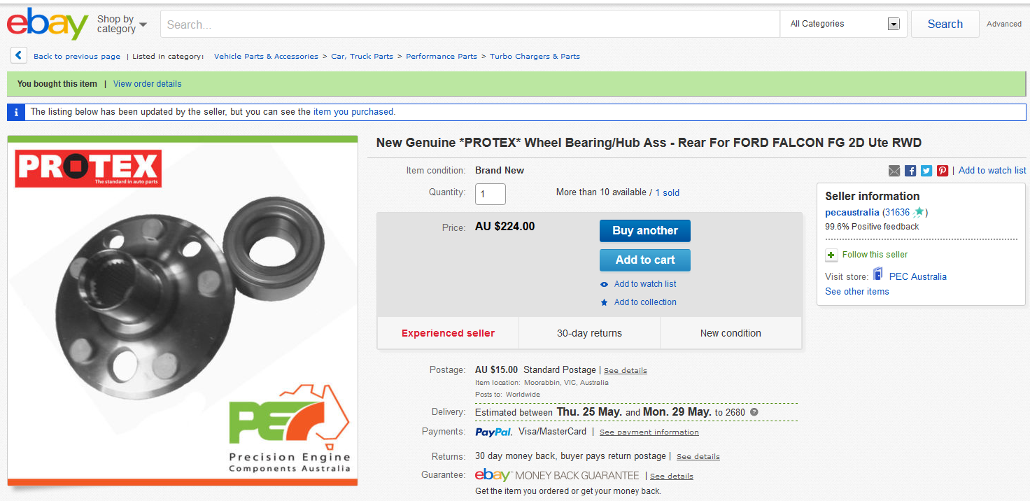

bupalooga Legacy Donating Member 262 Member For: 13y 9m 25d Gender: Male Location: Griffith NSW Posted 21/05/17 10:51 AM Posted 21/05/17 10:51 AM 3 hours ago, bamk2f6tornado said: Also you say you ordered a hub assembly?? I'm assuming this is for the front? If not the Ute's don't have a separate hub it's all one big peice mate A mate said to buy a whole assembly rather than just the bearing as that's what they usually do where he works & it would be a sh*tload easier as I don't have a press. Well this is what I ordered anyway.

bamk2f6tornado Legacy Donating Member 777 Member For: 12y 7m 28d Gender: Male Location: Rockhampton Qld Posted 22/05/17 06:04 AM Posted 22/05/17 06:04 AM A mate said to buy a whole assembly rather than just the bearing as that's what they usually do where he works & it would be a sh*tload easier as I don't have a press. Well this is what I ordered anyway.Your mate has taken a marijuana. That ebay listing seems to be for a sedan with the wrong description/photo. You want one of these. http://m.ebay.com.au/itm/FORD-FALCON-UTES-PANEL-VANS-XH-AU-BA-BF-FG-XR6-XR6T-XR8-REAR-WHEEL-BEARINGS-2-/301456633363?nav=SEARCHRepco is cheaper than this and they supply a Timken bearing inside a repco box. About $40 each side if I remember correctly. If you want to do the front bearings then yes it is easier to buy the whole hub as the bearing comes pressed in. Not the case for the rears mate. Just remove the bearing yourself and take the bare axle into a suspension shop n they will charge you bugger all to press the new stuff on mate 2
