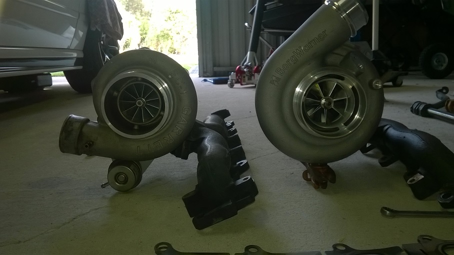

ScatterBrain Legacy Donating Member 316 Member For: 17y 2m 11d Gender: Male Location: Brisbane Posted 24/05/17 09:14 PM Posted 24/05/17 09:14 PM my old gtx3582 for reference. 5
OZYWALKER XR50T Legacy Donating Member 2,795 Member For: 13y 3m 11d Gender: Male Location: Western Sydney Posted 24/05/17 10:08 PM Posted 24/05/17 10:08 PM Gotta get me one of them.
Ralph Wiggum Moar Powar Babeh Legacy Donating Member 19,334 Member For: 20y 10m 20d Gender: Male Location: Perth Posted 25/05/17 12:42 AM Posted 25/05/17 12:42 AM 3 hours ago, ScatterBrain said: my old gtx3582 for reference. What spec rear housing? Got a boost v rpm plot? I've got an s364.5-sxe on my F6 and love it. #datspool

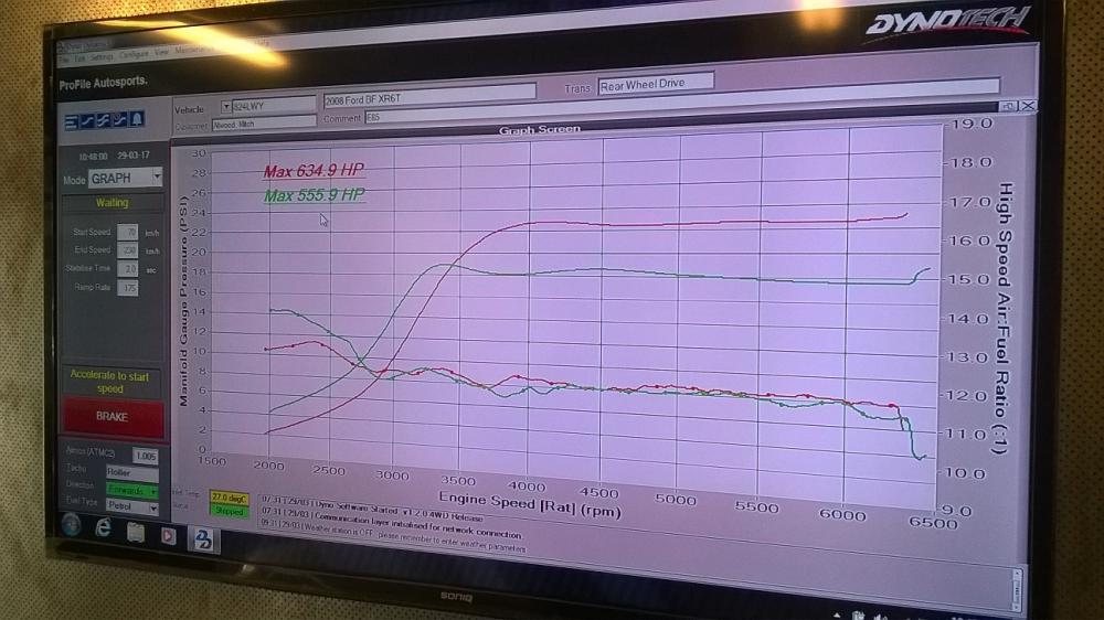

ScatterBrain Legacy Donating Member 316 Member For: 17y 2m 11d Gender: Male Location: Brisbane Posted 25/05/17 07:51 AM Posted 25/05/17 07:51 AM The rear housing is a modified .82 internally gated efr9180 housing, with the 80mm turbine wheel it flows just a bit more then the stock 1.06. By my calculations the choke threshold would be around 700 to 720 rwhp. Boost curve for second last dyno pull, Gtx3582r (Green) vs s369 (Red) 2
JETURBO ...JD TUNING ADELAIDE... Legacy Donating Member 23,708 Member For: 18y 2m 12d Gender: Male Location: Adelaide Posted 25/05/17 09:01 AM Posted 25/05/17 09:01 AM Hummm so what was the point of the bigger turbo ? at 470rwkw (630hp) the Gen 1 GTX82 is more than capable of producing that at 22psi with the obvious quicker spool time the talk that ball bearing over journal bearing is only 1/10th quicker spool speed so it's negligible but why did you effectively want a laggier turbo as it couldn't be from just the power generation but are you chasing grip or something ?
ScatterBrain Legacy Donating Member 316 Member For: 17y 2m 11d Gender: Male Location: Brisbane Posted 25/05/17 09:37 AM Posted 25/05/17 09:37 AM Basically for better efficiency. Yeah sure a gtx3582 can make 630hp @ 22psi but not as safely as the sx369. If you glace at the post above you'll see the AFR is around 11.6, If I was the lean it out to around the 12.4 which is about the average for a lot of tunes, it would make a reasonable bit more power. But as my car is setup for circuit racing and I have longevity in mind, I have opted to keep everything on the safe side, Timing included. On top of that not having a water cooled core means less heat it to the cooling system. 1

JETURBO ...JD TUNING ADELAIDE... Legacy Donating Member 23,708 Member For: 18y 2m 12d Gender: Male Location: Adelaide Posted 25/05/17 10:19 AM Posted 25/05/17 10:19 AM 39 minutes ago, ScatterBrain said: Basically for better efficiency. Yeah sure a gtx3582 can make 630hp @ 22psi but not as safely as the sx369. If you glace at the post above you'll see the AFR is around 11.6, If I was the lean it out to around the 12.4 which is about the average for a lot of tunes, it would make a reasonable bit more power. But as my car is setup for circuit racing and I have longevity in mind, I have opted to keep everything on the safe side, Timing included. On top of that not having a water cooled core means less heat it to the cooling system. And all very valid points mate ive never been involved with a circuit set up falcon but as you've shown it's no small challenge keeping a 4000lb barge cool and repeatable going around for minutes on WOT vs a 400mtr sprint that we're all very used to seeing 1
bossmang FREAKY Legacy Donating Member 12,441 Member For: 16y 7m 18d Gender: Male Location: Melbourne Posted 25/05/17 10:49 AM Posted 25/05/17 10:49 AM erm wouldnt the gtx be better for circuit?
OZYWALKER XR50T Legacy Donating Member 2,795 Member For: 13y 3m 11d Gender: Male Location: Western Sydney Posted 25/05/17 10:56 AM Posted 25/05/17 10:56 AM Small turbos run hotter freaky, falcons overheat easy at the track.
